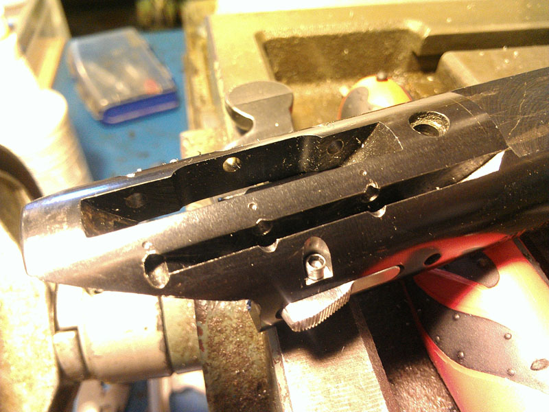

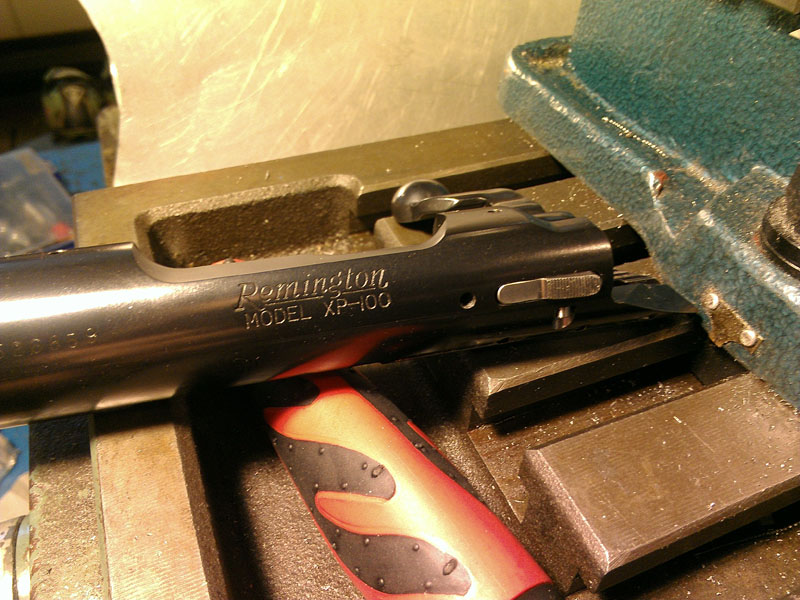

I got the release installed and works great. Just have to modify the tapered stop inside to allow the bolt to slide in without pressing the release. I used the PTG Lawton/Noster style release. The pin was made out of a 4-40 cap head. As for the spring, I just utilized the spring used in the factory release.
Turned out pretty good for the first one I ever did...
