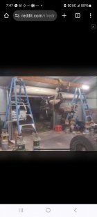

Recently I built a set of wheels to move a lathe and I was able to push it around myself, the lathe is sitting on plywood and the plywood is secured to the steel. The lathe has a heavy base and weighs around 1400kg, I wouldn't call this one top heavy.
