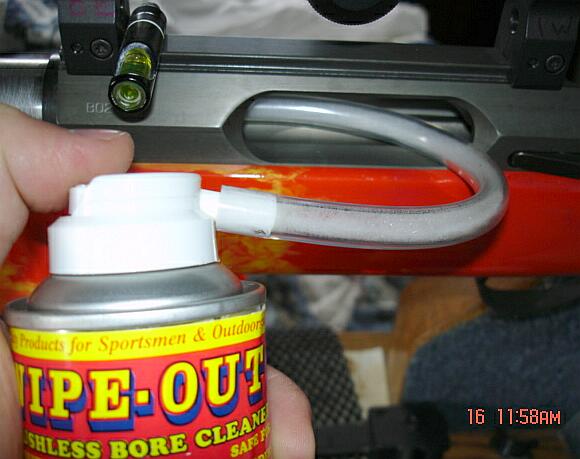

Been using it since 2000...Since the article, I have switched to applying WO thru a Lucas Bore guide...will have to get some new pics up...
1/4" ID polyethelene tubing,opaque) on the spout nested within som 3/8" ID vinyl tubing.
Applied in the rear of a lucas guide,without insert in) works absolutely perfect with no mess.

Use McDonalds soda straws in place of the tube.
Have also used Jack-in-the-Box straws. They're better.
No leaks.
Hammer...the tubing is reusable indefinitely, works better and will cost you less that a buck.
Straws are a PITA compared to the tubing
JB
