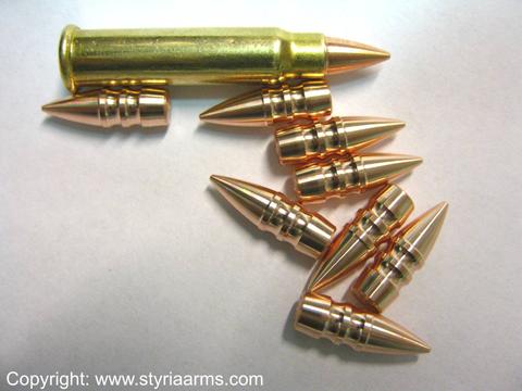

And to get the best performance, I also start to make AERO copper bullets with and without hollowpoint.
Michael, I just wrote a post on another forum saying the same thing. If they don't make a good rifle chambered in this new rimfire, I may have to build another 17 AH off a CZ527. My previous rifle was a Ruger and I did not like the feeding or the trigger.
