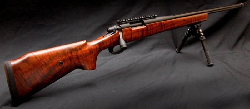

I have a stock from a 1968 Winchester Model 70 that I have removed the finish from. I am not sure what the stock is made of as far as the wood is concerned but I suspect it’s walnut. It’s got a very nice grain and the checkering is still sharp. I have no idea what to use for a refinish after I remove the dents. I’d like more of a satin look to it rather than the factory’s gloss finish.
I’ve attached some pics of the color/sheen I am trying to obtain. Any advice on the best way to get there is greatly appreciated.

Does it make for a darker finish? That is one think that I am trying to achieve... The factory stock was a little light colored for my tastes. Thank you.

Brownells has a French Walnut Stain with filler that works wonderfully and gives a deep, rich, slightly reddish tone.
Looks just like the pic you posted.
I tried the Arrow finish. It came out exactly how I wanted it to. Nice satin finish and it really complemented the factory stock wood grain.
I'm very pleased. Thanks for all of the recommendations.
