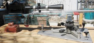

Here is a 6 in. wide Light gun I just finished. I definably can attest to the reduction in torque and improved tracking. ;D
Side view. 300 WSM, Nesika Action, Kreiger barrel, Chambering / Brake By Mark King. Custom rough blank from Richards Microfit stock . I did the rest, Tru Oil finish. ;D
