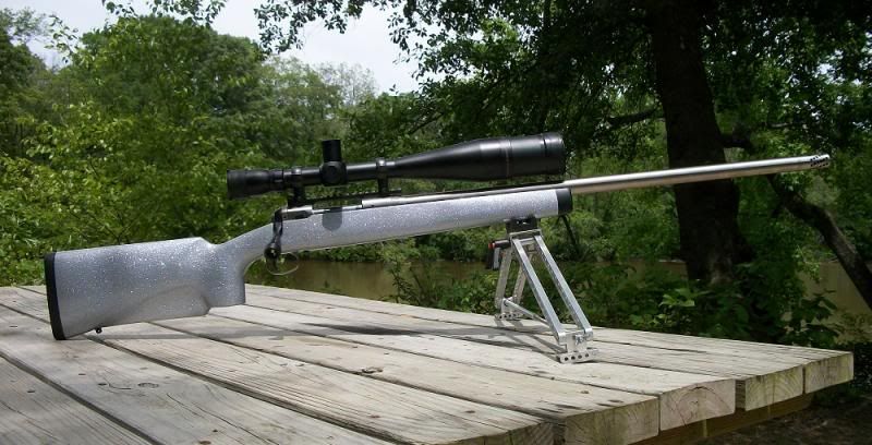

I make a stepdown stud that you remove one of you sling swivel studs ( as long as they a machine screw thread 10-24tpi. or 10-32tpi ) and attach my bipod to your rifle. My bipods don't flex like the sinclairs and are lighter and cost less and they are just as strong as the others mentioned, that cost almost twice what mine does. Here are a couple pics of my bipods on customers rifles in different states.

That is a nice looking rig!
Thanks, Quinc. Savage stock and action, Criterion barrel, and Sightron SIII scope.
I would like to add that I bought GNERGY's bipod about 10 months ago. And since buying it ALL my shooting has been done using his bipod. I put two small strips of luan under the feet so it slides easily. I liked that so well I modified my stock so it would slide straight back during recoil. Now I can see all my hits (and a few misses ;) ) on groundhogs and steel at ANY range.
