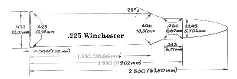

Here are the case sizes of the .219DW, 224 Ace, and the .225 Winchester, along with 22-250 for some comparisons.
219DW
224 Ace
225 Win
22-250
So it appears that the 224 Ace is a shortened 225 case with a 30° shoulder, that becomes basically a semi-rimmed 219 Wasp!
Furthermore the 219 and 224 cases are very efficient. If you look up load data you can get basically 3,700 fps with a 55gr from a 224 Ace with half the powder that the same 55gr takes in a 22-250.
I did also have concern that the 225 would be over-bored, but a 224 Ace necked down to 19 or 20 cal should be good and still get .220 Swift velocity with less powder.
RCBS has resizing dies to take the 225 to 224 Ace, as well as reloading dies (for .224), however I am sure that custom dies can easily be made.

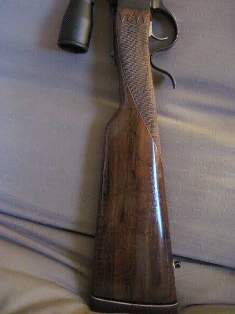

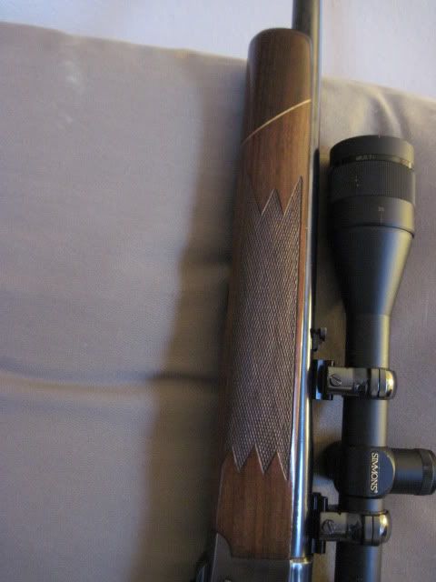

I was looking for a No.3 in .22 Hornet when I came across this .223 No.3 at a gun show a couple of years ago. I couldn't pass it up for $575 since it already had a Kepplinger set trigger. Someone did a nice job of modifying the original stock with recoil pad, checkering and forend cap. Here's a couple more pics. It doesn't shoot great, about 1" at best, but haven't decided what to rebarrel it to. I've got two .22 K-Hornet takeoff barrels that could end up on it.
Dave
