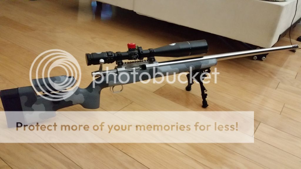

Here is the rifle I am bedding by the way...338 edge. Action and scope is shared with my F-Open rifle. Just swap out the barrel and stock and its like a new rifle. I have another Bat M multiflat on order so I will have 3 stocks and 2 actions to do any combination I want.
