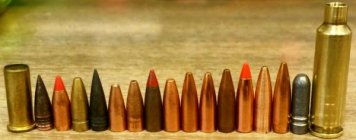

In response to another question about why did I pick such a difficult cartridge it's because it can perform almost everything from 17M2 to 17Hornet given the correct handload. It will even go down to 850fps with a 32gr cast lead RN on the right side with 1.2gr of 700X. On the other end of the spectrum you can go up to 3900 feet per second from a 18.75" barrel with the 17gr bullets on the left. 2950fps with H4198 and a 30gr.
Where some see difficulties, I see an advantage.
