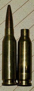

Chamber reamer, chamber reamer print, and fired (40° shoulder) & unfired cases, so, yep, most everything except the "oink" .
