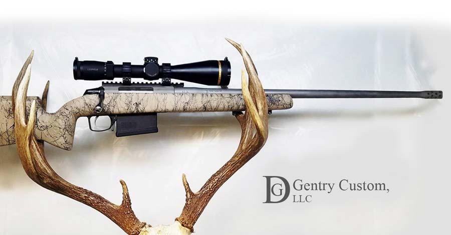

I've done Gentry's on Mauser's and If I had to guess it's the same for 700's. it's just grinding or milling an angle on the front side of the cocking piece for the safety to engage just like a Mauser or M70.![]()

A hole must be drill for the safety lock when the safety is full engaged , and another 'detent hole' made for the shroud latch that prevents over rotation of the shroud when the bolt is full open. Both must be precisely placed, along with alterations to the cocking piece so the safety lever can be operated into position to block the cocking piece/firing pin when the safety is applied. Get it right the first time, as there is no second chance without it being sloppy.I've done Gentry's on Mauser's and If I had to guess it's the same for 700's. it's just grinding or milling an angle on the front side of the cocking piece for the safety to engage just like a Mauser or M70.
