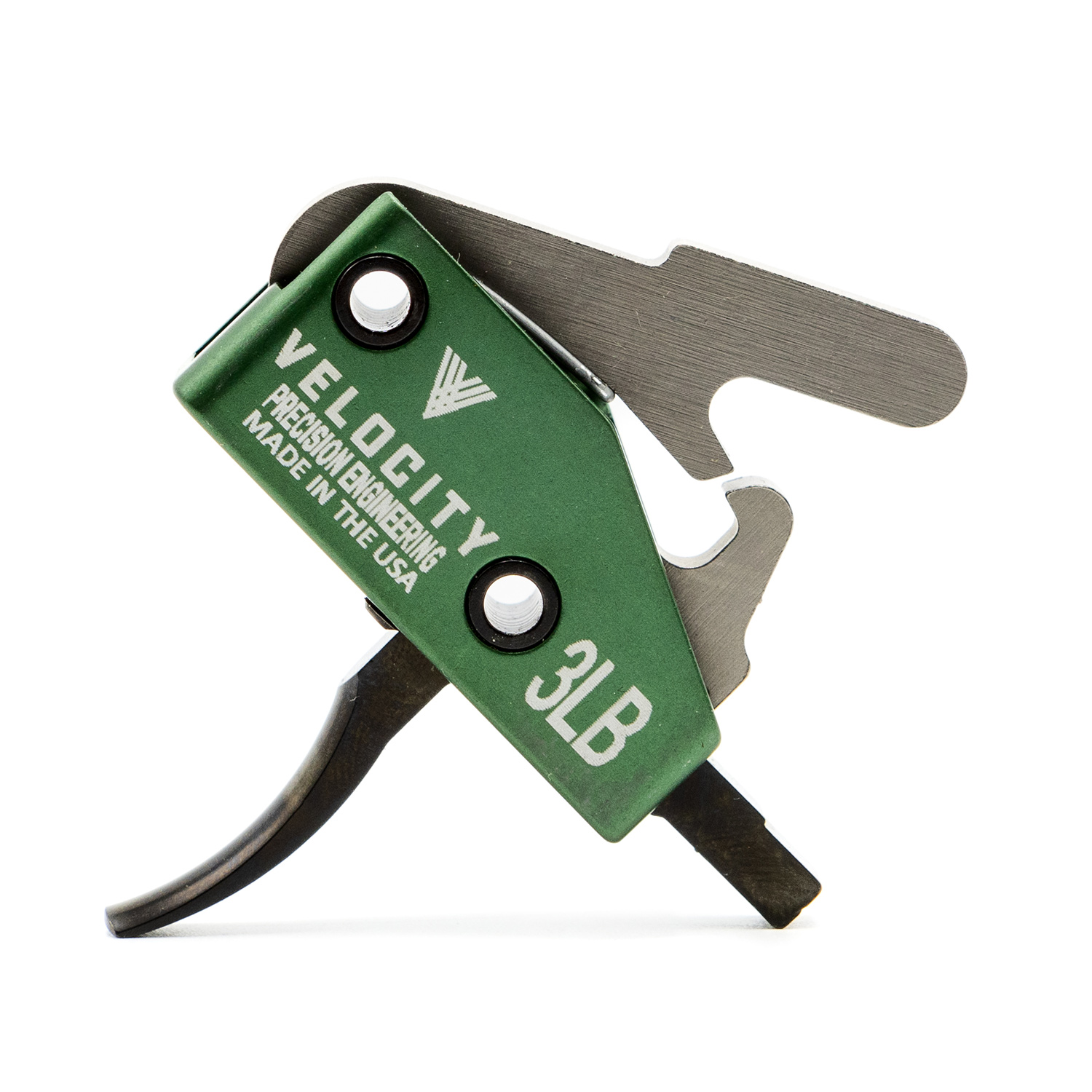

I have installed Velocity (3 lb) triggers in some of my rifles, and love them; company Owner used to work for Timney. Their standard triggers are great, and the MPC variant is perfect for my Spider Monkey digits.

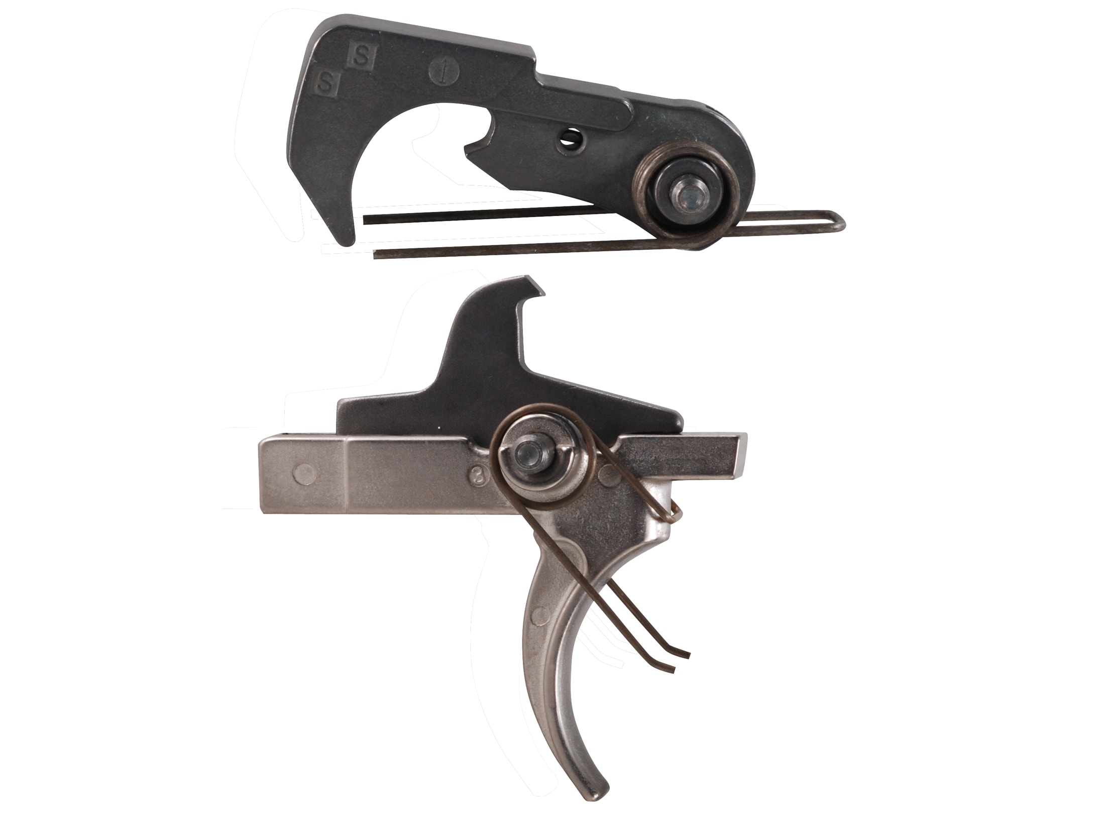

Like you, I had a “Standard” trigger in an Anderson Arms lower that weighed in at 7+ lbs. Popped out the old parts and installed an ALG as listed in the first link. Remarkable improvement at just a hair under 4.5 lbs and super smooth. By the time you ship your trigger out, pay for modification and return shipping, you could be ahead by just ordering this one.
ALG:
Velocity:
