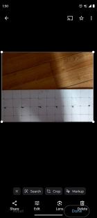

So yesterday turned out Great. It turned out better than I would had expected. I took four boxes of ammo. 3 for my new Gun. And one for my faithul.
Both guns had been shot earlier in the week. And I had started this thread on account of asking about tune for new gun. The new gun, will get some more done to it. Probably going to see where the top end of node stops. And finish sorting the new bullets.
So what happened great had everything to do with the old gun. I had changed the load in that gun on account of what I was doing to the new gun.
I rebedded the action in this liquid nail epoxy. That's a whole nother story. But, anyway. I resorted the bullets, by length, dropped down a node. Loaded right in the middle of that node. And after length sorting my bullets, every one came out with in a thousandth and half.
Here's the target's for the old faithful gun I all but cleaned the X count. The two top misses where from me not taking enough sighters. But When I started shooting, I didn't think It would had done this good. It out shot my new gun. And It gives me confidence it can shoot ten Xs. I know it can now. Maybe shoot 25 Xs. It just about did
This gun is just a Remington 700 with a
urbanrifleman 12 twist bbl.
@urbanriflemanI guess had I expected this,vI probably would had not done that good. This my best to date, so It's why I'm posting it.

Excellent!
Man I love those range sessions where you leave feeling that confidence. Very happy for you
