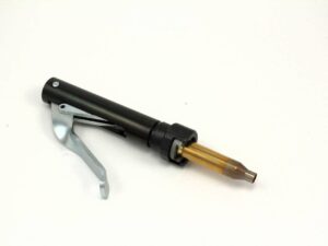

I've used this one for years. It's worked great for me and I especially like the option of screwing the head up or down for seating the primer depth.
cludes both large and small anvil assemblies.
Primer Seater Deluxe
If you want the ultimate in hand priming tools - the K&M Primer Deluxe will fit the bill.
Add for $67.90
