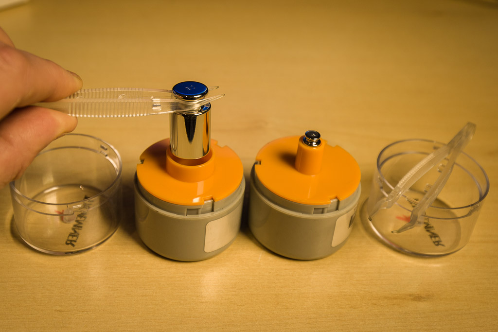

Check weights are designed to resist corrosion, and have storage and handling features to prevent contamination (e.g. from grit & corrosive finger grease), to work with special handling tweezers that hold the weight securely (avoid dropping/damaging/contaminating) and to sit stable when placed in the centre of a balance pan.
I agree that absolute precision is not usually necessary, so the more expensive weights can be avoided. I bought a 50g and a 5g weight, in order to check linearity and to have a quick check-weight close to the region in which I'm weighing; in practice I rarely use the 5g weight, but I do confirm the calibration every day I use a balance.

A 100 gram weight that is off by 0.644 grains is Class 7, not Class 1, but that isn't what is really important. What is critical is that you know the exact weight within a known degree of uncertainty.
