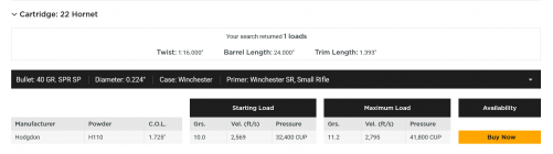

In general for any max load case you can divide the max velocity by the max load and the result will be a velocity difference per grain. 2506/8.8 or 285 fps/gr. Compares to the difference for 2400 given as 301 fps/gr. It's a pretty good approximation when no minimum is given.
H-110
  • Screenshot 2025-11-15 at 19-51-28 Reloading Data Center – Hodgdon Reloading Data Center.png
