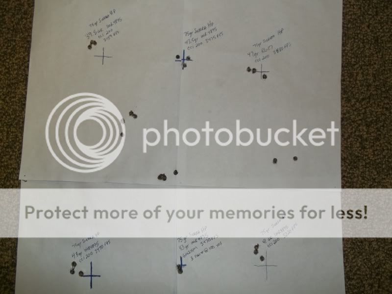

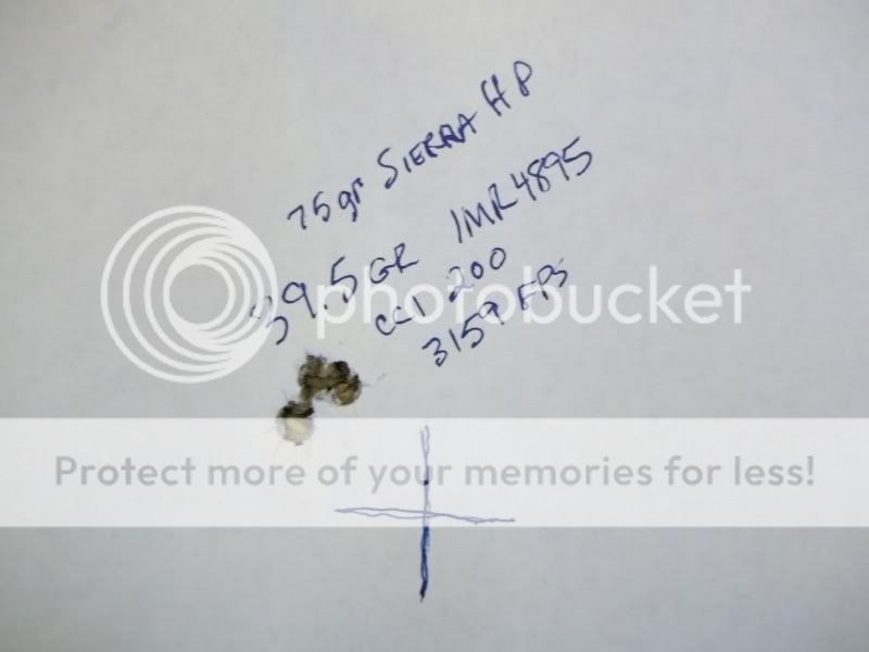

here's a pic of my best load using the 75 gr Sierra HP bullets and some other results using same bullets with different recipes. IMR4895 worked the best for me using that particular bullet. RL-17 gave good speeds, but not quite as good accuracy, but that doesn't mean your rifle won't like it.
Notice I have a bunch of rounds fired into the center of the make-shift target? Bad thing about factory barrels is that they gotta be fouled pretty good before they settle into good accuracy.
Groups shot from a 100% ALL factory Ruger M77 tang safety 6mm Remington with the varmint contour 24" barrel. Got a Bushnell 4200 6-24 scope on her. First Bushnell and really like it so far. Not too bad for a 34 year old rifle that still shoots the lights out :)
