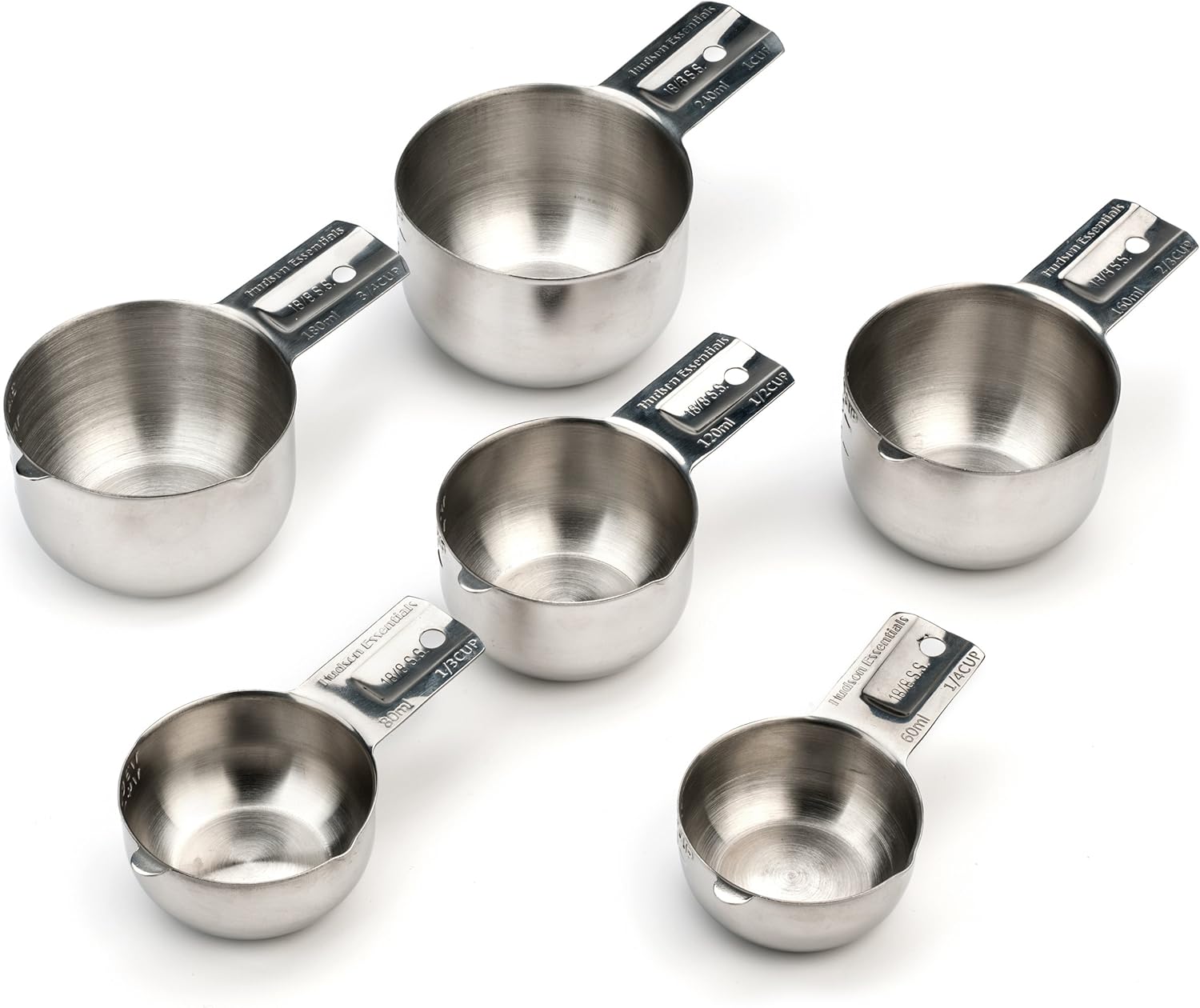

You might look at measuring cups in the kitchen section on amazon Stainless Steel Measuring Cups
