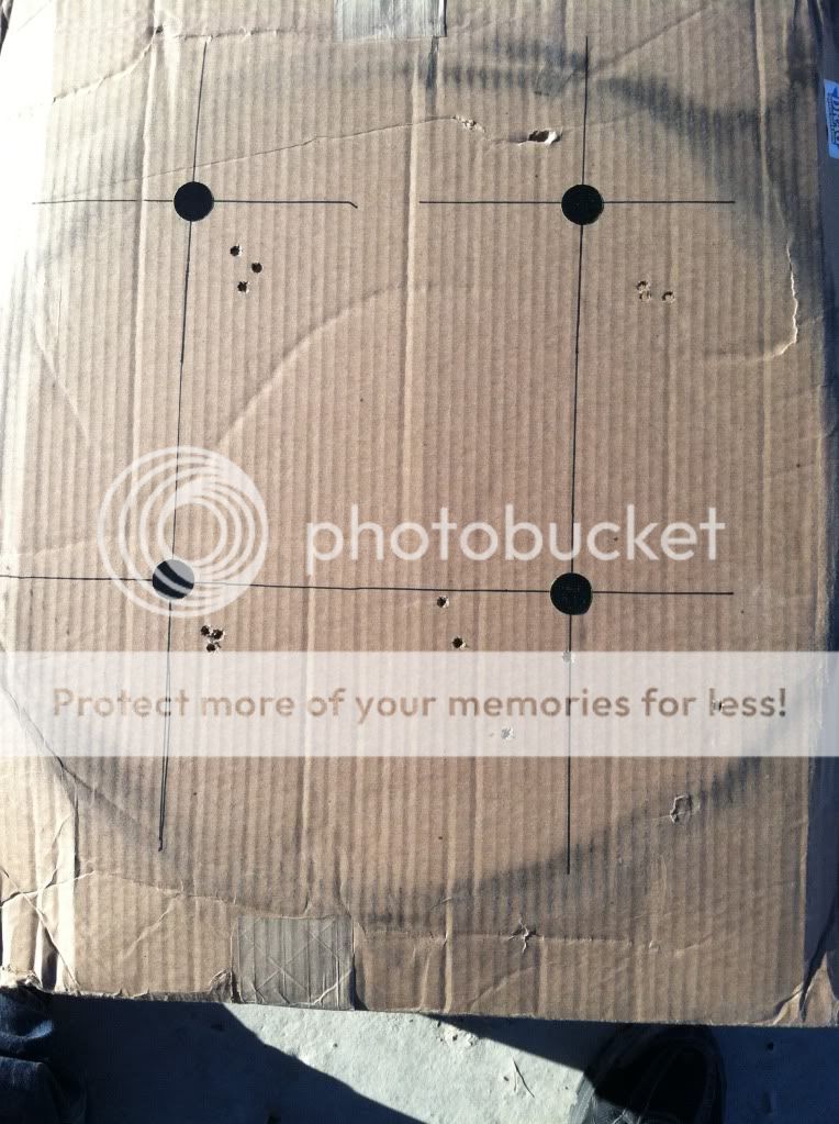

This is 5 shots in my 24" 1-9tw 7-08. From ershaw

Most manufactures of fine barrels make a 9, 8.5 and 8 twist 7mm barrel. Remington is set on 9.25 for some silly reason. It will not stabilize anything in the 168 and up class, unless the velocity is low. The 9 twist will stabilize the 162 AMAX without issue.

You aren't going to find any difference other that finicky seating depth with a 8 twist barrel. Here you go
