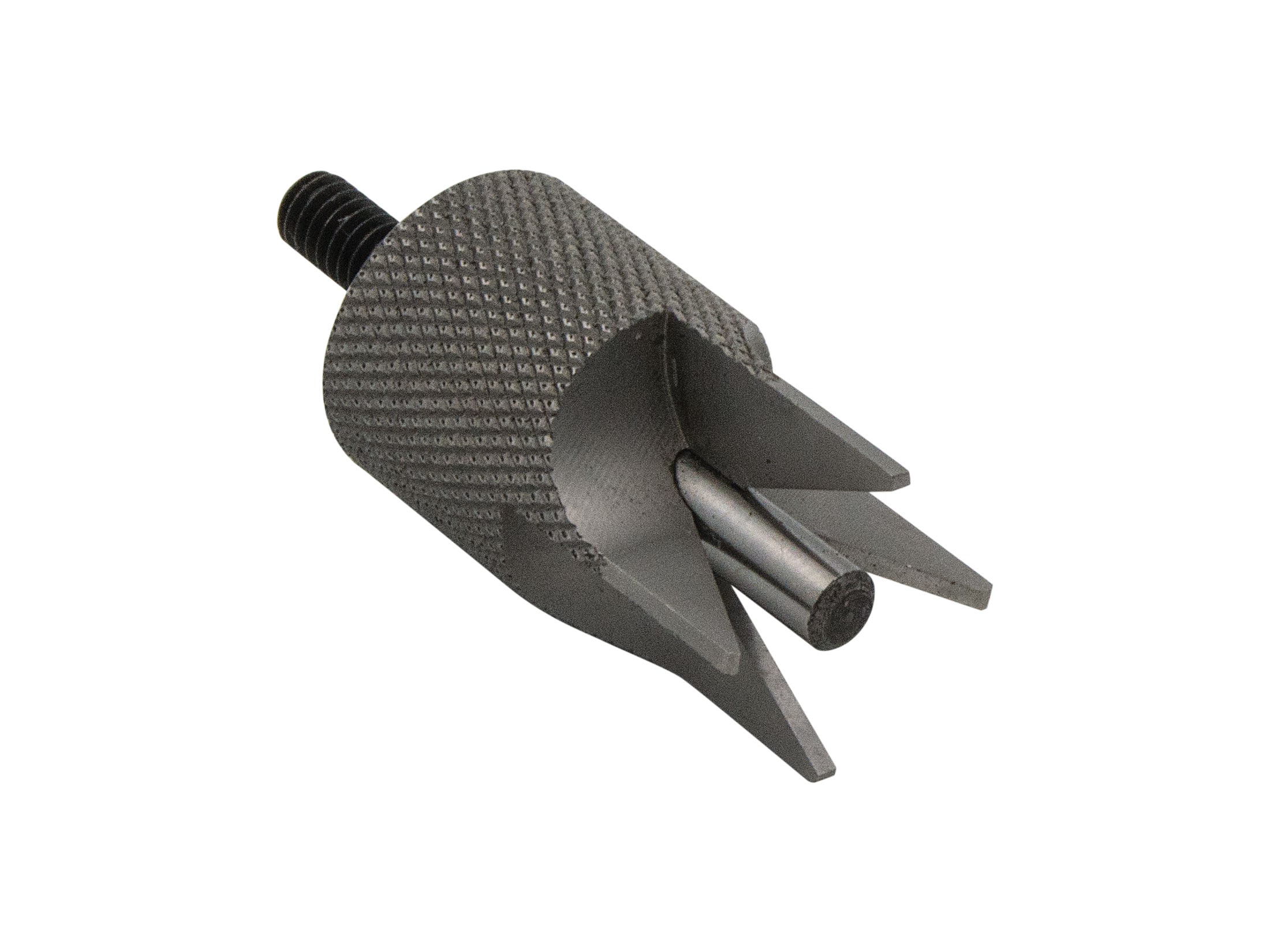

I use an RCBS case prep center including their tools for chamfering inside and outside of the case mouth. The outside chamfering tool seems to be getting a little dull, so I'm thinking about a replacement. Which inside and outside chamfering tools work best for you, particularly those that would work on my case prep center.
this because you can get consistent chamfering from case to case if you trim all the same first. it indexes on the flash hole. they make a shallower one also, but i like the vld.
then this for the outside, 4 blades work better than 3, less slipping.

The four blade Hornady mentioned in post #2 should fit your prep station.
