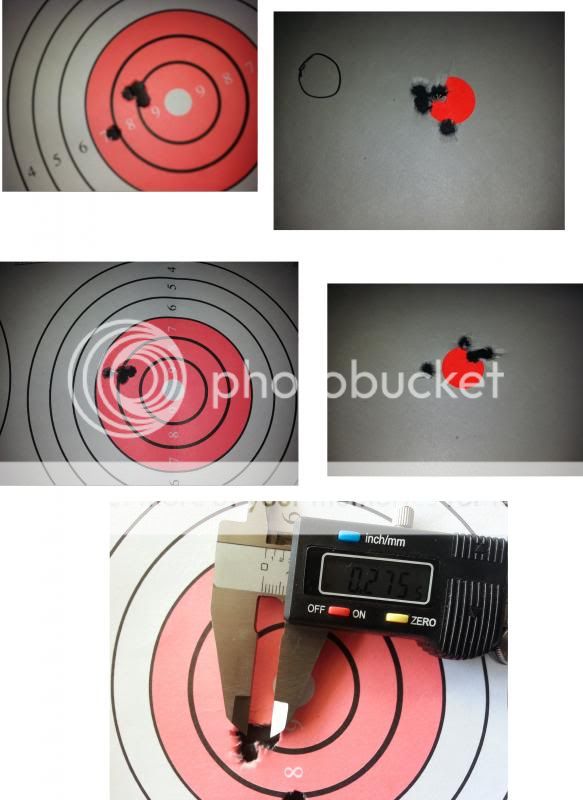

Where should I look for the cause of the flyer?
I just picked up a used factory Savage FTR 308 that had about 200 rounds down the tube. These groups were produced by several diffrent loads using diffrent components, I cannot isolate the cause of the flyer! The flyer occures wheather the barrel has been cleaned or after 75 rounds. The rifle has about 400 rounds down the tube, 200 by me in the last couple of weeks. The flyer is ruining what should be a 1/2 MOA or better rifle and turning it in to a 3/4 MOA rifle which is unacceptable!! All help is appriciated.

I would think that it is a combination of a few things..neck thickness difference, internal volume difference, powder charges not consistent, loaded rounds that differ in length from the shoulder to base or to ogive. if it were me I would check the necks first for one side thicker than the other.
hope this helps..
You say it does this with different loads? You have played with seating depth, powder charge, exc. Get a new barrel. :(
I was very consistant on the brass prep, Powder charges ect. "Lapua brass" I checked the barrel and it is free floating. I don't think it was the Indian! LOL. My other rifles, which I reload for are all 1/2 Moa shooters. The rifle did this whether shooting from the bipod or a lead sled. All rounds shot indoors so no wind.

Read Stan Pate's article on this same site about torque adjustments to the action screws. Google "Stan Pate Savage", the article will come up... I had the same problem, this recommendation cured it.
Thank you skibar_tex !...and....diego-ted, welcome to my world. I am having the same malody with a newly purchased, barely used Savage 6.5x284, but the flyer is much closer, just out if the group. The recommended article gives me new hope, and may just cure the situation. There is a wealth of knowledge on this site from some great shooters and great Americans. I could just be a little turn of a screw away from success. We'll see.
I did play with the tuning of the action screws a bit, not to the extent of the article, but it did not seem to have much affect on my problem, maybe I will have to take it all the way down and work my way up.
Diego
Ted, my two Savage 12F rifles never shot consistently until I had them pillar bedded. Then, they both responded as expected to load development and shot well and reliably.
Steve, deep down I suspect the stock may be the issue. I have sent the rifle to Larry at LPR, he works with the savage f/tr regularly. He will piller bet the stock and take care of any rifle gremlins. Then I will be sure the rifle can shoot all of it's potential. The rest will be up to me.

When you get this flyer do you mark the brass? Just because it is Lapua brass doesn't mean that it is perfect. It may be that the brass is causing the flyer. Next time you fire a few groups mark the brass that caused the flyer, and segregate it. When you have 5 brass that you know all go into the same hole, then try to shoot a group and see if you still have the flyer.

However, let me share this. My Savage, with its factory barrel chambered in .260 Rem (yep, they made a few) did the same thing -- spliting groups, often as much a 3 + 2 as often as a 4 +1. Drove me nuts. I changed brass (eventually necking up Lapua .243 Win brass). I tried a half-dozen powders, and every bullet type I could get my hands on. I filled up a spreadsheet with load info testing every possible seating depth.
Then I screwed off the factory tube, and put on a PacNor 3-groove supermatch, chambered in 6mmBR. No other changes to gun -- same trigger, same stock, same scope, same rings.
With the new, custom barrel the split groups ceased. No more flyers -- just like that. In fact I had 120+ rounds through the gun before I had one shot that wasn't at least touching the main cluster at 100 yards. Read more here: http://www.6mmbr.com/gunweek036.html
I'm with Steve on this. Get the stock bedded. I have a Savage BR model that was 'walking' in the stock. Just got it back from being bedded and haven't shot it yet for a range report. I suspect it will be fine now.
I will definitely get my stock bedded, but being a 6.5x284 I think I will just shoot it out this year and re-barrel, bed and make other planned changes over the winter months.

I went to the range today with the standard load I shoot, plus up and down for powder. Brass and loads were the best I can make them. Rifle barrel as clean as I can get. Shot everything over a chrono. I set the action screws at 30,30,25. Vertical so I ended up with 45,45,30 on my pillar bedded stock.
Several thimgs I noticed. Clean bore, speeds were low but very good in es/sd. As I shot five shot groups, speed came up as bore fouled, es/sd went up as well.
After 30 rounds, a small break to simulate a relay change, I shot my last 15 shots like I would in a relay. 100 yards, light wind. I ended up with a group just as his. 12 shots, about 3/4"....3 shots 1" away in a 3/8" group...
