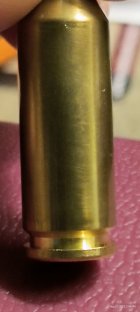

Oh, they can be loaded to hot in Texas...6 PPC out of my Viper last month at a match..108 degrees in the shade. 220 Russian brass 5th firing.
