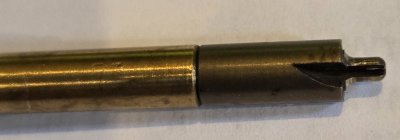

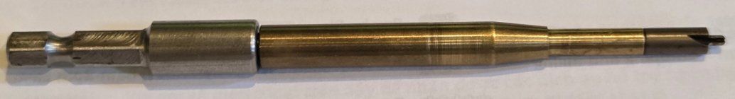

Likewise, I've found that as good as the Lapua brass's quality is, I still deburr their flash holes when I first get them. Most of them don't have a burr, but a few of them do and my 21st Century deburring tool easily takes care of them.
