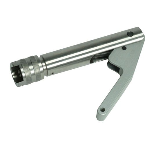

Want to upgrade from a RCBS Bench mounted tool. Learned to cry once and get the best you can get. What do you use and why??.
Thanks
I have the K&N, the Primal Rights and the C21. I think it depends on what you want for accuracy vs speed and ergonomics. In my opinion, the K&N is most accurate but not too comfortable to use. The PR is fastest, but not as accurate. The C21 is slower than a PR but more accurate and comfortable. Boyd Allen mentions the Sinclair unit with the screw down top and is probably extremely accurate and looks very ergonomic, but I don't own one. I use the C21 and it is my favorite.
For those shell holder-calibers not offered by Derraco, does anyone know if the Sinclair International precision shell holders (Lee-footprint) will fit the PCPS?
they work, i tried it with my cheytac
I agree Wayne, I use the 21st Century (I have 2, one for 6PPC and the other for BR) the only problem is arthritis in my hands and squeezing that booger is getting harder! I've had and sold the RCBS bench mount, didn't like the time it took to load the tube but may have to revisit or find a half priced deal on a primal rights primer!!
Well, a revisit is in order, priming some brass Friday and my fingers started cramping and drawing up, had to stop priming, work with my hands to get the cramps out (can't do anything with the arthritis) and back at it, 3 or 4 pieces later hands cramping and fingers drawing up, may have to look for the primal rights, looking under the cushions of the couch!
I could have written your post. I did the same thing, there was a Primal Rights up for sale here with some accessories a few years back and I did a quick scope sale along with an " I'll Take It ". My arthritic hands thanked me.....
