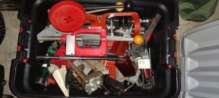

What part is this?
Is this to a case lubricator like a Lyman?
Looks like the manual priming arm like on my Rockchucker
Most people pull them off and use a hand priming tool
On a Rockchucker, there is a cross pin hole where you can attach that part
insert primer by hand, one , at , a , time
then prime on the downstroke up through the bottom of the shellholder
it aint worth much since nobody uses it, i think it was inclued on some presses just to ensure a guy could at least prime if he didnt have all the tools yet

Thanks. I now know what to put it with. My dad had his organization in his head. Lol
I was going to say that is the Lee bin, but I see a green powder measure in there, lol!
yeah i wondered if that is a lee priming arm and mabie thats why i havent seen one like it. it looks a little to good for that though and it doesnt look like a rcbs-redding or lyman that i have seen. someone on here would know wat it goes to.
Oh, so many young folks don't remember.
That is a primer arm for the World Famous Herter's presses. Like all the Herter's line, Mr Herter liked things to be robust, and therefore the Best.
There's a nifty Ideal #5 powder measure in that tub along with an early Lyman 450 lube/sizer. And lurking at the very bottom is???
