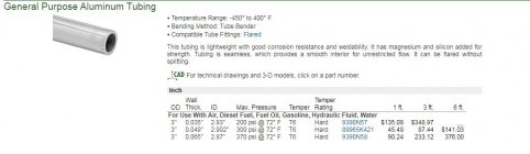

McMaster 3" OD tube, .049" wall (.049" is the cheapest). Cut a .100' or so length, put it in with retaining compound, face off and machine ID to dimension. Any of the Loctite bearing retaining compounds will stick to anodize when used with the primer. BTDT
