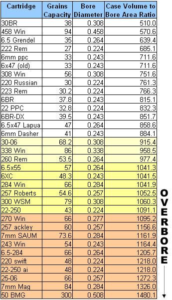

Well one magic "ingredient" may be the case volume to bore area ratio ... i.e. the "overbore index".
As a general rule, a very high percentage of the really accurate cartridge are very "under-bore" -- this applies to the 6 PPC, 6BR, and, yes the .222.
Now, mind you there are some truly overbore cartridges which have proven accuracy. But take a look at this chart. Compare the cartridges in the white zone (underbore) with those in the orange zone (overbore).
Overbore Index Chart
