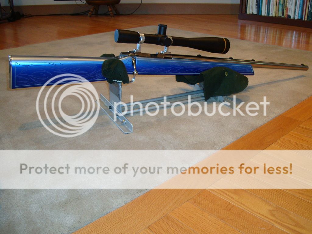

This rifle is configured a little different than the norm in that I'm using a stock best known for it's short range success, Scoville. But it's long enough to handle a 28" HV Krieger with some weight in the butt. I think my next build, that I'm working on now, will have a Shehane tracker or something like that in a laminate construction.
