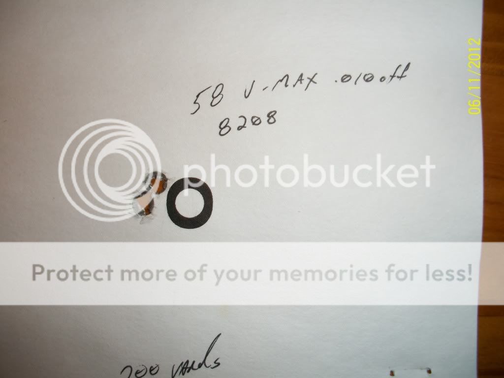

I've had my ups and downs with my PPC. This past weekend I worked up some varmint loads. I got the 55 Nosler BT's going pretty good with benchmark, but I think the V-max got them once I switched to 8208. These groups were shot at mid day without windflags, mirage was kicking around a bit. The little bit a vertical might have been from that, I still might play with the seating depth but they really performed. The load is kinda stout.
The gun is a go between for both ground hog shoots and shooting ground hogs ;D
200 yards
300 yards
Thanks. I still need to do more than 3 shot groups. I've been fighting keeping my PPC in tune with N133. I've tried several loads but that stuff is hard for me to pin down.
