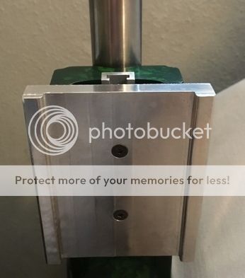

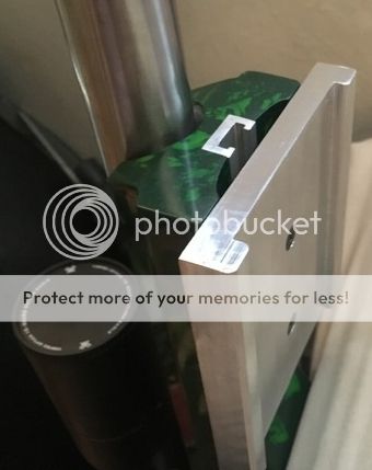

Norbert Costa in Boise, helped me build this 4" trackplate this week so I could use my 3" wide f-class gun in a 4" benchrest bag. We'll see if it will help tame the 300WSM for use in 1000 yard benchrest.
I used plates over the last years and found they do help with tracking. but i tried to keep them as low as possible. I don't think you will have advantage in torque because of the hight of the bore above the plate. The other issue is keeping the plate square and parallel to the stock..... jim
Hi Jim, appreciate the input. We discussed making it thinner, and you're right. Having it too tall would negate some benefits of controlling torque, we should probably mill that down quite a bit thinner. I noticed Boyd mentioned in an earlier post about adding adjustability by making one of the holes slotted, might look into that as well. Any suggestions welcome by PM, as this is still work in progress, thanks.
Thats interesting because Ive thought of making plates to use with a number of my rifles. I did wonder how the height would effect them. Also wondered if I could keep them from wobbling a little. The little screws many times used are not to substantial in my view. Now the rail like shown above seems like the best idea for a plate to me. Off topic here but where I really want to use plates is with my rounded forend rifles. Thanks for the input.
