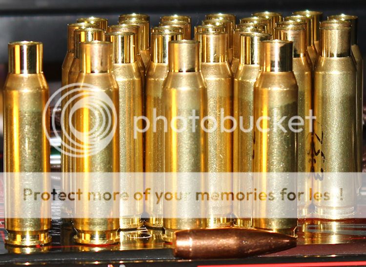

Well i just weigh sorted 200 pieces of the.new creedmoor brass. All but 18 were within 0.5 grains and those 18 were less than 1 gr. Weight varied from 165.48 to 164.78. I would call that consistent.
Started checking necks on the same brass. Decided i need to run an expander in them to straighten out some dents and chamfer first. I will be back with a report.

Ok i just checked necks on 100 pieces of new lapua 6.5 creedmoor brass with my sinclair neck checker. Now i have a neck turner but am trying to avoid using it
I culled 5 pieces of brass. One was just thicker on one side, two had flash hole problems and wouldn't fit on the rod, one had like a lump or.bulge in the neck in one spot now this is after running an expander mandrel in all the cases and one case was just thicker than the rest all the way around by about .0015.
The rest were very consistent .014 to .0145 neck thickness. Less than .001 in neck variation most less than .0005
Now this is the first time i have done this. Just wanted to know what this brass really measured. I feel like this is pretty good and there is no need to neck turn. Recreational shooter only.
What do you guys think?
