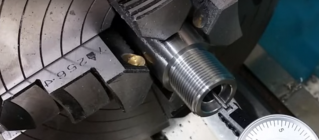

End dial the bore and use an outboard spider. No way to allow a barrel to gimbal in the 6 jaw. I could set something up if I had to, but the 4 jaw is faster.
However you’re making it gimble in a four jaw applies in the 6 jaw. The gimble setup is pretty much independent of the number of jaws.
Only thing I can imagine is if the max diam of the jaw is too small relative to the barrel and there isn't enough room to get the gimble setup around the barrel?
^^^This.
I don't use my 6-jaw buck for chambering, either. If you're using a 4-jaw you must be using some method like copper wire to allow it to gimbal, it would be the same for the adjust-tru. For me, I have the 6-jaw dialed in to a few tenths and I prefer to leave it that way to use for machining ops and use the spider for barrels. To each their own...
Getting 4 little "inserts" between the barrel and jaws is enough work. I don't need to juggle 6 with jaws that all open and close at the same time. I don't want to use copper wire. It moves.
I don't adjust within a couple of tenths, I dial until it's zero. That's easier to do on a 4 jaw.
An adjust tru is way easier than a 4 jaw. It doesnt loosen up each time you move it- torque never changes. A copper ring is all you need
The adjust tru type chuck is basicly a 4 jaw so far as how you adjust it. The benefit is equal force on each jaw. The main reason that a copper ring moves is because on independent jaw chucks theres different force on each one. The adjust tru chucks fix that. I dont use a ring but if you do thats the best chuck.
I'm willing to give it a shot. I'd like to use it because it's a much more well balanced chuck on top of everything else. I find the adjust-tru part a bit annoying to fine tune but I probably just need some muscle memory for it.
In my head this looks like a great way to gimbal the barrel. Don't have the tools to get those brass inserts in the jaws though.
I do some thin wall work where a 6 jaw would be useful. I currently do barrels with a 4 jaw. If an adjust-tru type 6 jaw could do both, that would be excellent. Is there any issue with the clamping force on a 6 jaw, for barrel work?
You get way more holding power for the same tightness. Its not going to slip
