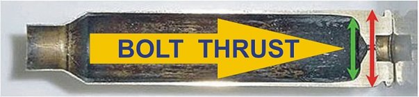

Well lets look at it with a little math.
A magnum bolt face (.532) at 65,000 psi has a theoretical bolt thrust of 14,495 lbs.
A standard bolt face (.473) at 80,000 psi has a theoretical bolt thrust of 14,080 lbs.
Not much difference. Having fired this cartridge already and inspected the fired cartridges for pressure signs, it really points out the limitation of a brass cartridge. Bolt lift was easy and primers were not flattened.
You are figuring the internal case head diameter of the magnum case as about .446?
I think the theoretical bolt thrust of the standard bolt face is lower than 14,080 lbs
Here is what I figured:
A=(pi)*r(squared)
A=(3.1415926)*(.266*.266)
A=.2222 sqin
P=.2222*65000 psi
P= 14,443 lbs for a mag bolt face
using the same above for a standard bolt face (.473) is how I came to the answer I did. there may be a little deviation as I did round the pi value and the area value just to keep from typing out alot of numbers. I stand by them unless you can prove different.

The mag boltface, or, more accurately the SAAMI spec for a mag case rim, is indeed .532.
Did you consider that the internal case diameter is smaller than .532" for the mag case? Therefore the bolt thrust needs to calculated using this smaller number for diameter/radius which will reduce the calculated bolt thrust. Similarly, the internal case diameter for the standard case is smaller than .473".
I am not arguing for or against your assertion, just looking for accurate calculations.

this also brings up an interesting point of does a 40 deg shoulder increase bolt thrust over a 20 deg shoulder?
The thing that you haven't taken into account in your calculations is how much thrust is being retarded by the case gripping the chamber walls. That is where the shoulder angle, or more accurately the amount of body taper, plays a role in bolt thrust. A cartridge with a 35 or 40 degree shoulder usually has less body taper, so it will grip the chamber walls better than one with a tapered body normally associated with the standard 17.5-20 degree shoulder.
So, an "Improved" cartridge will usually exhibit less bolt thrust than a standard one.
