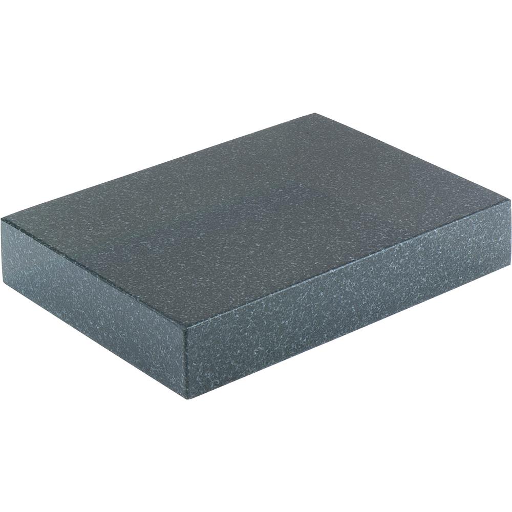

Granite surface plate and sorbothane bumpers.
I live in the hometown of Grizzly so i just picked it up in person and didnt have a shipping charge.
The surface plates arrived today from Grizzly. These things are great. They have near sequential certification numbers, and identical build dates, but they’re clearly from at least 2 sources of granite. Either way, they’re a great addition to the bench. Some serious stability here. The SuperTrickler is currently out for warranty repair, so the bench does look a little bare without it.
