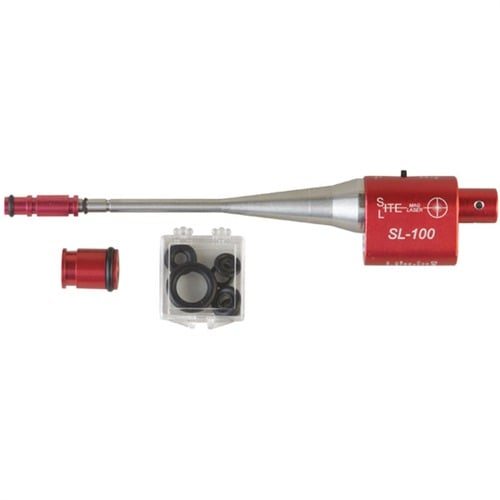

If you don't have one of those cute little boresite gizmos, or cannot bore sight because of rifle design (M14/A1, Remington or Browning auto-loaders, etc), then I recommend getting a big target and getting close for that first shot. Otherwise, I like to bore sight at a 100 yards. With an unknown gun, ammunition, and optic, i will use three rounds to check the grouping and make adjustments from the center of that group. This will usually save ammunition in the long run.

I started using a laser barrel bore sighter.
