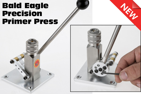

This thread makes me glad my thumbs start to act a little arthritic. Made my Sinclair priming tool uncomfortable to use. Now I use one of these. Single primer machine.
Giving the primer tube on the Dillon 550 a measuring glance...
