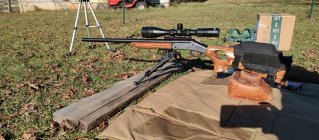

On the frame has give me the best results, though it's a bit... difficult
That being said have also been playing with mounting a bipod as far back and close to the frame as possible and things have been , interesting
Both was shot fairly similar.
