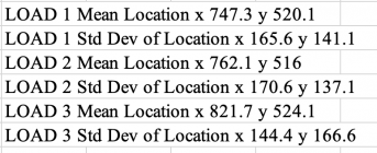

I downloaded Kieth's data and looked at it in relation to Loads 1 and 2 and whether or not the group locations were moving around on Load 1.
When you look at all 33 shots as a group and calculate the mean point of impact you find that LOAD 1 and Load 2 have almost the same group center and the vertical and horizontal standard deviation is extremely close and not statistically different by the F Test method. The Load 3 mean point of impact is moved horizontally and the distribution is similar to Loads 1 and 2 but now spread more vertically than horizontally. Practically Loads 1 and 2 are the same. Statistically speaking they are the same for this test.

For simplicity let's consider Loads 1 and 2. If you compare the average distance between the group POI and the 33 shot average POI it turns out that Target 1 is 100.1 with a standard deviation of 32.93 and Target 2 is 87.25 with a standard deviation of 27.87 This is based on only 7 values and when compared by Welch's T test (for mean distance) and F Test (for variance) there is no statistical difference in the offsets of the groups.
Anecdotally it appears that the Load 1 groups do appear to move but all nearly within the range of Load 2 groups. We do not have any information that can identify why the group centers move but one possibility is purely sampling and random dispersion. Was it the shooter? If Load 1 and 2 were tested again would the same pattern repeat? The answer is we do not know. What we seem to have is data indicating that Loads 1 and 2 are almost identical in mean POI and in dispersion with less vertical dispersion than Load 3.
This is a situation where 33 shots is not enough to determine if there is a difference between Loads1 and 2 mean radius or average point of impact. It is also not enough data to determine if the point of impacts for the two targets is actually different.Screenshot 2024-06-07 at 8.39.45 AM.pngScreenshot 2024-06-07 at 8.39.19 AM.png
