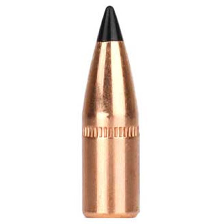

SD guy and Mark, I found these for less than 15.00/100 shipped. Ordered 400 to start/play with. The place had over 300 boxes, so I should be able to get more.
The Hornady 2266 bullets arrived. I loaded up some.
Fed range brass, C450, H335(25 gr) seated to 2.220

Mid-South has the 62 gr BTHP Hornady bullet back in stock. It has been an excellent affordable “all purpose“ AR bullet that only recently became available. https://www.midsouthshooterssupply....ameter-62-grain-bthp-with-cannelure-250-count
They also are offering a 55 gr polymer tipped bulk bullet at a very attractive price that sure looks like a Hornady V-Max with cannelure. I am tempted to give those a try myself.
