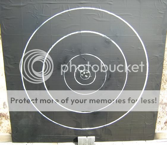

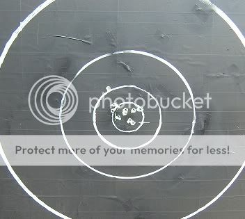

Thanks so much for your input - ALL of you!! Went to the range today to try the "square yourself up with the target" method you all suggested. Fired at my home-made shoot-n-c target at 300yards. 10 shots into 2.75 inches wide by 1.75 inches high - with the first sighter a bit high and left. Only used this new gun 5 times but best group I've done - first shot was right in the middle.
Good shooting and can you tell us how you made your target? First I've heard of a home made one and looks like it works well.

The shoot-n-c target I have explained on other web forums so I will just copy and paste....
The target I made today is standard Full Bore 300yard size but I can use it back to 1,000 (if I made a 1,000 yard target I wouldn't be able to lift it!)
On your cardboard or whatever you normally use to put your targets on, glue down and cover the target in fluoro A4 paper. Then cover the lot with clear packing tape. Finally spray paint the lot with matte black. When the bullet strikes it knocks a small section of the paint off the packing tape allowing the fluoro green (or whatever colour) to be seen quite easily with a high mag. scope or spotting scope.
Frame took about 1 and one half hours, just copied the 300yd frame at the rifle range, because I need to be able to lift it onto the frame by myself. Putting the paper down: I sprayed half the area with contact adhesive, waited a few minutes for it to tack off then just lightly sprayed the back of each piece of paper, one by one, and stuck them straight on. Got my son to help with the packing tape part but it can be done alone, just don't stretch the tape: pull enough out to go from one side to the other,let it "relax" and then stick it down. I smoothed it down with a dry paint roller. I overlapped each length of tape by about an eighth of a inch. The matte black paint was easy and dries quickly. All up it took about 2 and one half hours. The circles I put on are in-between the size for 600 and 700 yards and I included a super V as I shoot F-Class Open. I downloaded some plotting cards to record each bullet strike.
The target can be patched out with sticky tape and then just touch up the black paint. I used a white paint marker for the lines but I have now bought a "chalk marker" which is similar.
