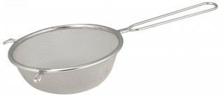

Simplest way is to use a cheap ass blow dryer from Wall World and a matching cheap ass strainer to roll & flip them around in till they're too hot to handle, less than five minutes.....
