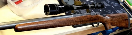

I re-barreled this old M77 tang in 6mm Remington. Had it powder coated and did all the stock work myself. Made a great classic looking Mauser style rifle. Topped it off with an old Japanese built Tasco scope. Shot really good and loved the look of that stipled fancy walnut :)

That looks like a very nice job on that stock. I have a soft spot for those tang-safety Rugers too. WH

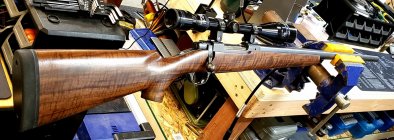

I'm trading into this modern mauser, I believe its in a Richard's microfit.
Rifle was previously owed by our local gunsmith and mauser guru.
280ai 20" Pacnor 15-20 rounds.
It's going to make an awesome truck gun once it's got a BC'z dye job.
