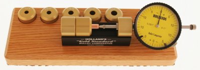

I have proven to myself that it does work. It's simply all about
ignition and keeping the consistency closer. I use a Hollands
comparator, Not shown is the separate die that acts like a full
chamber, then I screw on a wide , flat tip to fully cover the base
of the case. Even with some of the good stuff, I have found ones
as much as .015". it's either from the material itself or a deformity
at the base. The Hollands is pretty fast. I'll take a pic of my actual
set up if someone needs it......

Proving something to yourself does nothing towards proving it to the rest of the world, unless you have data it becomes an opinion.
Hey John,
Since I can't get to the test center this is the only way I can use ammo that I just buy when I can find it. last year I did decently shooting sorted ammo. I am not known to keep data records like some. I provide what has worked for me.
if others try what I am doing, and it helps good for them if it doesn't well at least they answered any question in their mind.
Lee
