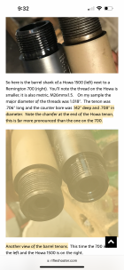

Metric threads (at least on the old howa made ones) so make sure your change gears are capable. Make a test tennon before ruining a blank. My change gears do not track on every metric thread. Its .257. Never seen a print so I measure everything old school. I have done 3 of my own and had to releif cut the shoulders as they pulled hellish hard. Mag bolt face allows other options if you want to step away from 257 or weatherby in general.
