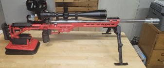

Voodoo Three60 ammo
It's reportedly chambered for Lapua .22LR match ammo, Center X, Midas+, or X-Act -- they use the same bullet and are otherwise indistinguishable to the eye and in dimensions.
Of course, the fact that the chamber is "designed" for Lapua doesn't mean that it will shoot all Lapua equally. Some lots will be better or worse than others.
All my Vudoos, to include my 360, shoot everything excellent.
The chamber is built around Lapua ammo, but I mainly use Eley.
Heard back from Voodoo today and was told that the Three60 chambers unlike the V22's and others are using a Winchester 52D reamer. The 52D is a rifle but I didn't know it also was indicative of a specific chamber. Anyone know more on this?
In gunsamerica.com on July 11, 2021, Steve Gaspar writes "Per Vudoo, the Three 60 chamber is cut for Lapua ammunition." https://www.gunsamerica.com/digest/vudoo-three-60-22lr-review/
