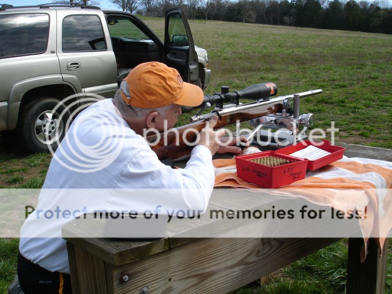

Voldoc paid a Sunday visit to my range to test
the hybrids at long range. We warmed the
Bat SB BRX up with the 105 Hybrids at 600 yd.
Muzzle velocity was 3,050 fps. 600 went very
well in the switchy winds and mirage.
Next Doc went to 700 yd and zeroed on the big
plate and shot a couple of shots. Now he was
ready to take on Ole Chuckie and Chico, the
Colorado prarie dog, at the 800 yd line.
Doc dialed the NF 42x up a few more MOA and
took a sighter. Dirt and grass flew up near
Chuckie. A minor adjustment and Doc was
ready for the kill. Doc took careful aim holding
the Seb Neo joystick and touched off one.
A half second later Ole Chuckie laid back with
a center mass shot to the chest, a heart shot.
Doc quickly loaded another round and moved
over to the smaller prarie dog. He touched the
Jewell trigger and sent another Hybrid on its way
toward destruction on heavy metal. Chico rocked
with another heart shot. Voldoc nearly touched
the one inch bullseye painted on Chico.
Here is the result of two consecutive shots at 800 yd.
Voldoc at the 600 yd line. 700 yd plate visible in
background. Chuckie and Chico at 800 are the
small white dots back near fence line.

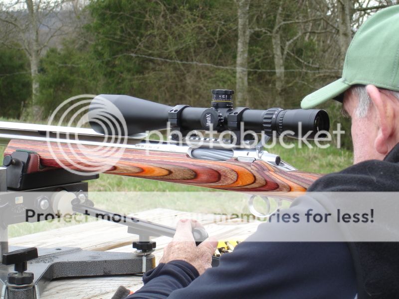

Voldoc's Bat SB BRX with french walnut (?) stock

I think she is a Bat SB, Bartlein one inch at muzzle, 8 twist.
Maybe Doc will chime in!
Specs on the 6BRX=
BAT SB action=
RBLPRE= multiflat= Diamond fluted bolt
Shehane T-1000 French Walnut laminate
w/ Tracker butt plate=
pillar bedded and clear coated with
> 15 coats of auto premium clear=
Bartlein special contour barrel 1.125 at 28"=
8 twist=
weight all up= 16 lbs. 13.8 ozs
6BRX no turn chambering with a .271 neck=
Jewell 2 oz. BR trigger=
Shehane + 20 MOA rings=
Nightforce 12-42 NXS with Double D reticle=
105 Berger Hybrid=seated .012" short of lands
H-4895 powder=
CCI- 450 primers
Redding 6BRX type "S" FL die from Robert Whitley=
.268 Redding bushing
velocity 3,050 fps=
All I can think of this AM=
thanks for the interest=
Doc Stone
