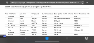

Hi I wonder how the new vv n555 will work in 300 wsm

Pretty sure Norm Harold uses that combination for his long range F class set up. Its a winning combination but you need to do your own load development to validate accuracy and pressure limits.
