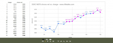

An observation: It was evident from the start, At long range, the vertical dispersion is at minimum when the adjacent loads are linearly increasing and not on a flat spot.
Here is a detailed load development test from a 1/3 MOA rifle at 660 yards, which is done by a third party. This load had a minimum vertical dispersion not on a flat spot, but when adjacent charges are linearly increasing.
IMHO new "theories" are written by people that do not understand the basics of the original LADDER process. once again with over 50 yeas of shooting , i will tell you, without any reservations, the original 20 shot ladder works as designed to assist in finding a workable load PERIOD.
"An observation: It was evident from the start, At long range, the vertical dispersion is at minimum when the adjacent loads are linearly increasing and not on a flat spot."
explain please
explain please
Load 10, 11 was selected as a candidate for best vertical dispersion
Load 17 was then selected as another candidate.
Load 17 won and was selected as the best load for this rifle/powder/bullet combo

Here is the deal, please show your load development where being on a flat spot resulted in the lowest dispersion at long range. Fine tune as much as you want as long as you show that your best vertical dispersion load was on a flat spot on the original ladder test
