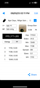

Load #1: 8gn of Clays, 190gn Sub-x, Federal 210 primer. Powder measured out using Lyman Gen 6 which seemed to always throw off by about .3gn so hand trickled the remaining amount to 8gns.

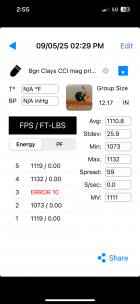

Load #3: same as load two except I used magnum rifle primers.
Load 1: image 3887

Load 3: image 3885

Now in the pics on the 3rd set of 5 I got an error on the 3rd shot and that was the outlier.
Next step may be 8.5 grains but I really think 8 grains is good for now. I am going to load some more using the trickler only to 8gn, non-magnum primer and use ballistics gel to see what damage is done.
Oh and these were all at 95 yds from a rest

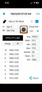

All
Was able to acquire 2 cans of Trailboss. Using 190 Sub-x and first 10 rounds were loaded to 10gn and second set of 10 rounds was loaded to 9.5. Pretty happy with the 9.5gn load out. I did one set of 6 rounds prior to today at 10.5gn and they were both quite subsonic so have these two loads.

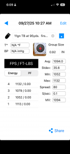

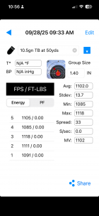

So was able to get out today and shoot a few rounds quickly. Some were subsonic and some were transonic. Going to try 10.5gn of TB tomorrow with the 175 Sub-x.
Seems so far the 190gn is best with TB
